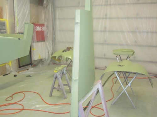

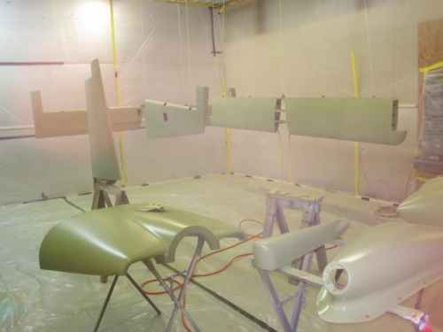

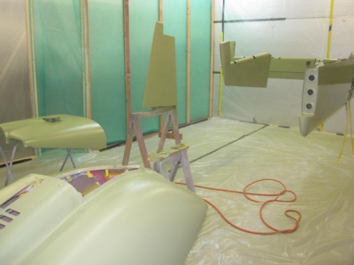

Primer - Tail Feathers & Cowl
All the pieces were wiped down with MEK and a tack cloth.
Two thin coats of Sherwin Williams CM0483505, a high performance, high solids, low VOC, two-component, green corrosion inhibitive epoxy primer, were applied.
