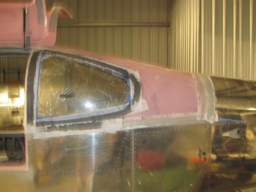

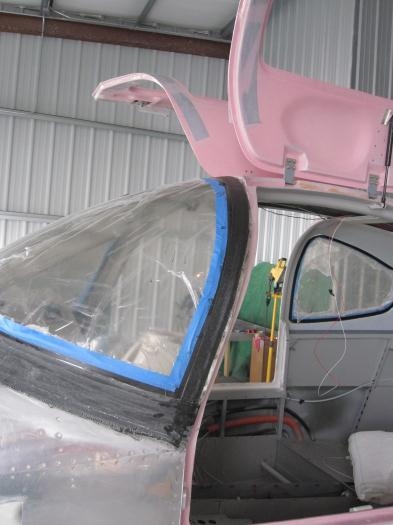

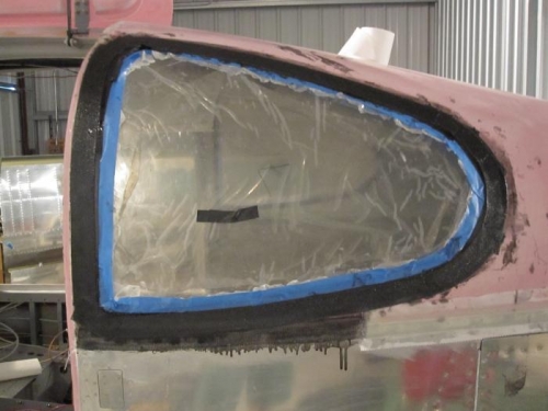

I put fiberglass on the windscreen and rear window joints. I also dyed these pieces of fiberglass black. Additionally, I fiberglassed the cabin cover joints with the fuselage. Two layers of fiberglass were put on all joints. Peel ply was put on and I cleaned up all the epoxy drips.
Fiberglass on the top windscreen joint
Fiberglass around the rear windows
Peel Ply on everything
