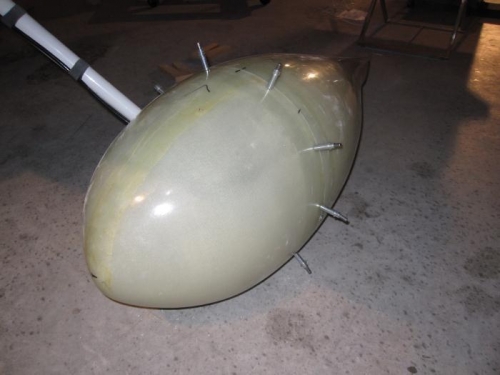

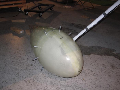

48-7, Step 1
The U-10048 Nut Extension butts to the U-10S7B-L Wheel Fairing Rear at a spot where the wheel fairing rear is sloped.
Form in place a surface parallel to the outboard end of the nut extension using more epoxy/flox mixture. Having already roughened the inner surface of the U-10S7B-L Wheel Fairing Rear aggressively using coarse sandpaper at the 1/4" hole the epoxy mix may be applied to the fairing without having to remove it from the bracket. Apply mold release or tape to the washer if you want to be able to remove it later. Apply an epoxylflox mixture to the inside of both wheel fairings in the area adjacent to the nut extension and washer. Cleco the wheel fairing front to the wheel fairing rear. Ideally pocket will also be formed in which the large washer may seat. Allow the mixture to harden then remove the wheel fairings.
Left
Left
Right
Right
