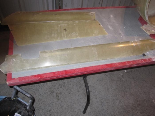

Cut out the templates for the U-1018A Nose Gear Leg Fairing found at the end of this section.
Drape the Aft Template over the U-1018A Nose Gear Leg Fairing and position it. Double check that the measurement was taken to the cutout (shaded area) and not to the forward edge of the template. Transfer the outline to the part and trim.
Glue the Forward Template to a piece of stiff paper and position it onto the U-101BA Nose Gear Leg Fairing. Transfer the oulline to the part and trim accordingly. The template defines a conservative 'zero clearance' fit with the nose wheel fairing so the gear leg fairing should require additional trimming.
Trimmed Nose Gear Leg Fairing
