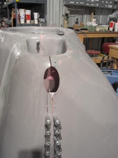

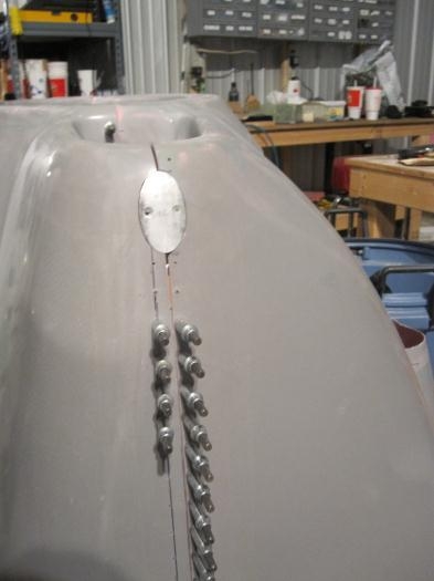

We marked and cut the hole per the instructions on both cowl halves. Then Brad covered the two templates, then we taped them into place.

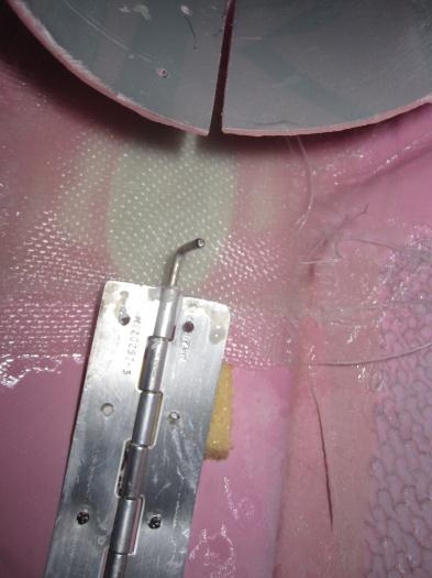

Brad then coated the back side of the template and filled in any gaps with micro balloons. When the micro became tacky, Brad installed four layers of fiberglass.
Hole Cut
Template installed
Four layers of fiberglass on the interior of the cowl
