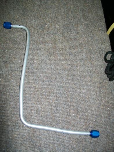

Date:  10-11-2009
Number of Hours:  0.50
Manual Reference:  37-4
Brief Description:  Fuel lines
37-4, Step 6
To minimize fuel pressure sensitivities, I am mounting the fuel sensor in another location, so I won't be mounting it per the standard plans.
If not using the Flo-Scan or FT-60 make a fuel line that directly connects from the ES Airflow Fuel Pump to the AN837-6D 45° Elbow Bulkhead Fitting attached to the F-1001 Firewall Bulkhead Assembly. This fuel line should follow the alternate fuel line depiction shown and have adequate clearance from all parts of the aircraft structure.
Step 5 - Not applicable
37-4 Completed per plans
37-5 through 37-6 - not applicable
Fuel line from the pump to the firewall
