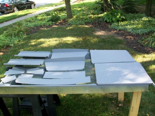

First batch of primed parts

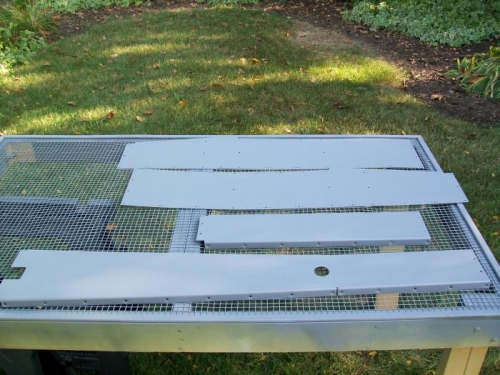

Second batch of primed parts

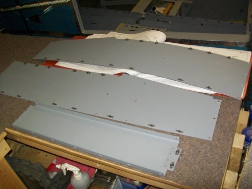

Side panel and tunnel cover nutplates riveted
