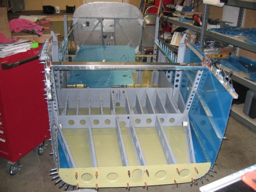

Manual Reference: 29-5, 29-8, 29-9
Brief Description: Middle fuselage skins
29-5, Step 4
Remove the F-1006B Bulkhead from the Tailcone Assembly. Cleco the F-1070-R Mid Side Skin and the bulkhead to the underlying structure and check that the mid side skin is properly formed.
29-5 Completed per plans
29-8, Steps 1, 2, 3, & 4
Cut the F-10100 Baggage Door Shim into F-10100A and B Baggage Door Shims. Remove the tabs and debur the edges of both parts.
Final-Drill #30 all the holes in the upper flange of the F-1023-L and -R Baggage Floor Angles. Debur and dimple these holes.
Cleco the F-1023-l Baggage Floor Angle and F-10100A and F-10101 Baggage Door Shims to the F-1070-L Mid Side Skin. Final-Drill #40 the holes common between these parts except the holes marked in Figure 2 do not drill.
Cleco the F-1023-R Baggage Floor Angle to the F-1070-R Mid Side Skin. Final-Drill #40 all the holes common between these parts.
29-8 Competed per plans
29-9, Steps 1, 2, 3, 4, & 5
Cleco the F-1070-L and F-1070-R Mid Side Skins and the two F-1 015F Spacers to the under structure.
Final-Drill #40 all the remaining 3/32 inch holes common to the F-1070-L and F-1070-R Mid Side Skins and pre-punched under structure. Final-Drill #30 all the 1/8 inch holes in the wing root area.
Position the F-1046-R Mid Fuselage Longeron on the F-1005E-R Gusset. Clamp the parts together. Match-drill #30 and cleco the holes in the gusset into the mid fuselage longeron.
Align the lines drawn on the outboard face of the F-1046-L and -R Mid Fuse Longerons with the corresponding holes in the mid side skins. Match-Drill #40 the longerons using the skin as a drill guide at only the locations fwd of the F-1034C Fuselage Bulkhead. Align the lines drawn on the outboard face of the F-1013-L and -R Fwd Fuse Longerons with the corresponding holes in the mid side skins. Match-Drill #40 the fwd fuselage longerons using the mid side skins as drill guides.
Check the distance between the aft most rivet hole and the aft end of the F-1013-L and -R Fwd Fuse.
29-9 Completed per plans

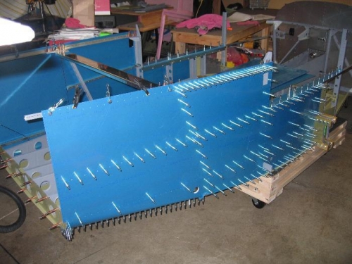

Left middle fuselage skin

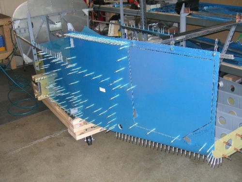

Right middle fuselage skin
Rear view of the fuselage
