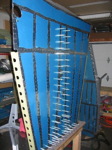

I continued back riveting the forward fuselage floor ribs. Brad will be stopping by tomorrow afternoon to assist with riveting the center ribs. My arms aren't long enough.

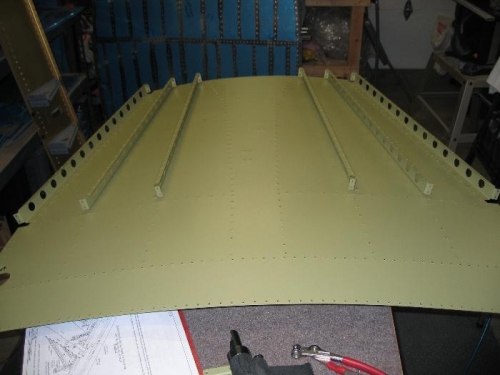

Ribs all riveted
Firewall and forward fuselage cleco'd to the bottom skin
