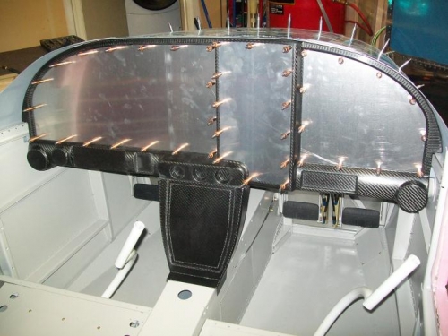

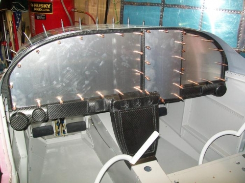

Brief Description:  Instrument Panel Insert
Renee assisted me this afternoon with drilling the mounting holes for the instrument panel inserts. I drilled a #27 hole through the carbon fiber instrument panel and the aluminum support panel.
The next step is to drill the mounting holes for the K1000-06 nutplates on the support panel.
