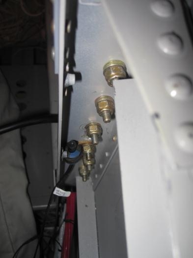

I then wired and installed the forward door alarm switches on both the left and right doors.

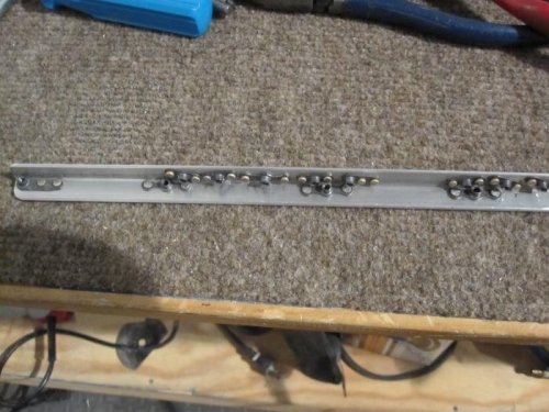

I spent most of the afternoon working on the two rails for the radio stack. I added nutplates on the front holes. Then I added nutplates to the existing holes on the sides. This allowed me to get rid of all the nuts and making screw clearance easier to manage going forward.

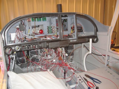

Aftewards I put the carbon fiber panel back in the fuselage. There was one hole in the left panel insert that wasn't drilled in the panel support frame. I drilled that hole and will have to install a nutplate during my next session.

Carbon Fiber Panel back in the fuselage, still have a few wires to hook up on the panel inserts
Left Door Alarm Switch installed
One of the rails for the radio stack with nutplates installed
