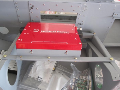

Install the VP-X Pro into it's final resting place underneath the panel.

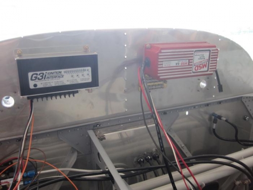

Mounted the G3i Electronic Ignition units on the aft side of the firewall.

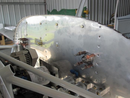

Installed two firewall penetration kits from Plane Innovations. Cut the 1" hole in the stainless steel firewall took awhile and inflicted several injuries to my hands. The stainless screws that I have are too long, so I'll have to order some shorter ones before completing the installation.

VP-X Pro installed
VP-X Pro installed
Firewall penetrations
G3i Electroni Ignition
