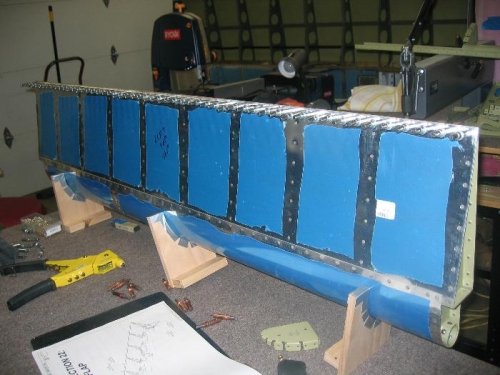

Brief Description:  Assembled and riveted left aileron
21-6, Steps 2,3, & 4, Riveted top and bottom left aileron skins to the spar and leading edge skin.
21-7, Steps 1,2,3, & 4, Riveted the main ribs to the spar and aileron top and bottom skins.
All that is left is to proseal the trailing edge and rivet. I am going to wait until I get both ailerons and both flaps completed so that I only have to mess with proseal once.
