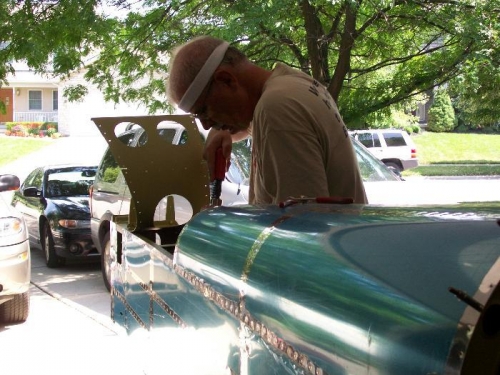

Match-Drill #30 all of the holes of the F-1010C-L & -R Bulkhead Doublers into the F-1010 Bulkhead and F-1010A Horizontal Stabilizer Attachment Angle. Be careful to drill square to the bulkhead, particularly when drilling into the angle.

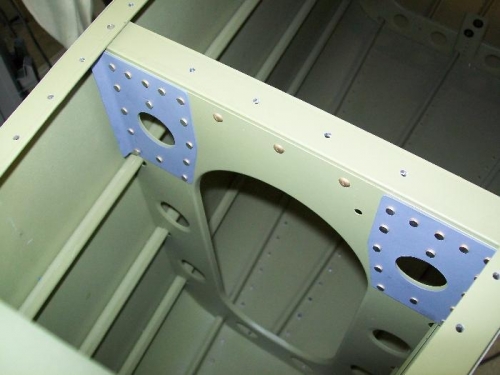

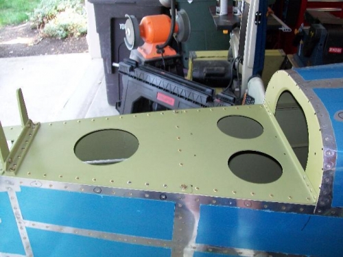

Rivet the F-1010C-L & -R Bulkhead Doublers to the F-1010 Bulkhead and F-1010A Horizontal Stabilizer Attachment Angle . Position the F-1010B Spacer back in place on the F-1010A Horizontal Stabilizer Attachment Angle, then cleco the F-1014 Aft Deck back in place. Replace the two AN4 bolts that secure the F-1014 Aft Deck to the F-1032-L & -R Longerons and, to maintain alignment while riveting, temporarily place AN3 bolts in the four holes in the aft deck that are used to secure the front spar of the horizontal stabilizer. Rivet the F-1014 Aft Deck in place.
I'm match drilling the holes in the doubler
The doublers all riveted.
The aft deck riveted back into place.
