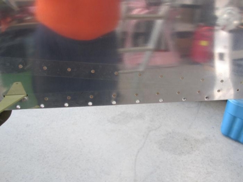

Brief Description:  Dimple Rudder for Fairing
I drilled the holes for the lower rudder fairing with a #19 bit, then dimpled the holes for a #6 screw. This will enable me to take off the fairing to service the tail light.
