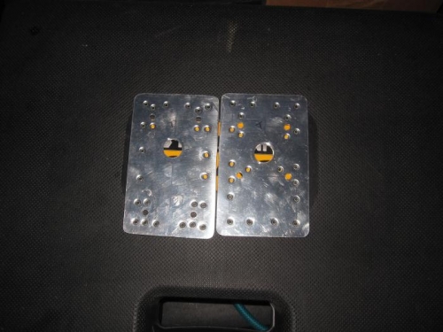

Fabricated a pair of doublers for the GTN-650 antenna and the ADS600-B antenna based upon a Garmin doubler design I found in the Garmin G3X manuak for the GA 53.

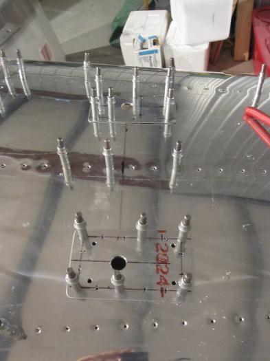

I then proceeded to match drilled the doubler and the fuselage top skin. Afterwards, I deburred and dimpled the holes.

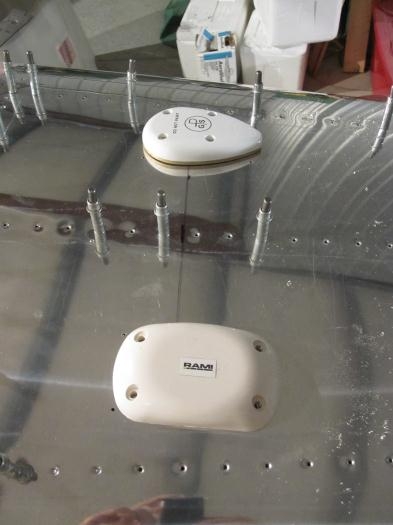

The two GPS antenna
The two GPS antenna
All matched drilled
All matched drilled
All dimpled
All dimpled
