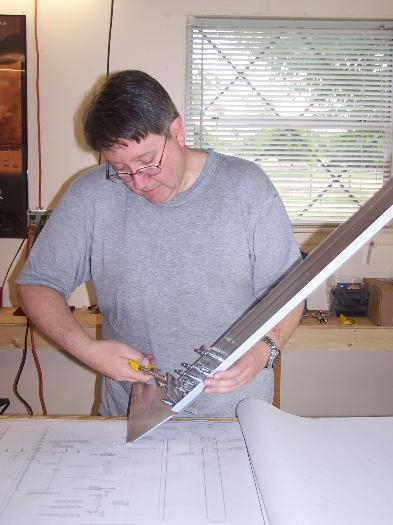

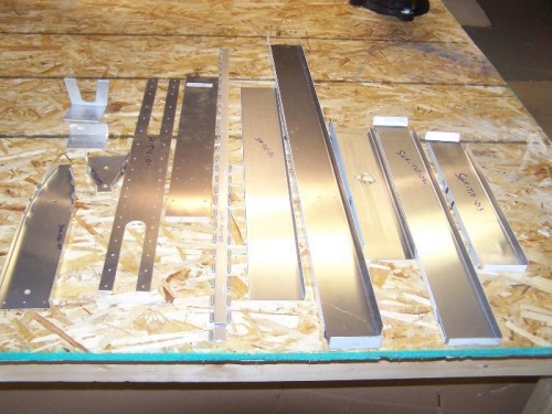

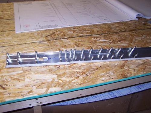

Productive day. On 5/2, prior entry, fab'd all detail parts for SNX-T12. Today, fabricated all detail parts for SNX-T10, channel stock for the vertical stabilizer. Progressed on to SNX-T09, where the detail parts come together for sub assemblies. Completed SNX-T09-02, the vertical stab forward spar subassembly. Moved on to SNX-T09-01, the vertical stab main spar. Drilled all pilot holes and cleco'd together SNX-T12-01, SNX-T-12-03, SNX-T12-02, and SNX-T12-04. Just have to up-drill to #30 now and rivet after deburring and cleanup. After that, work the holes for the AN3 bolts on the lower end of the vertical stab main spar.
Cleco'ing Front Vert Stab Spar

Remaining Vert Stab Frame Ribs

Cleco'd Vert Stab Main Spar
