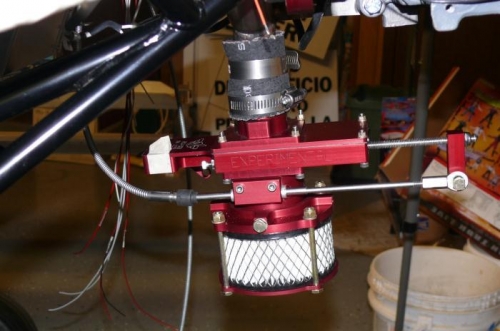

I then thought I'd see how well the throttle & mixture cables fit. The mixture must be cut to length, so it was fine. Initial thoughts on the throttle cable, however, was that I had a problem - it just didn't seem long enough. I re-checked the AeroCarb manual to see if the carb orientation was wrong (wasn't). Finally saw in the AeroCarb photos that the factory birds have their cables run just like mine in pic 2 below, so I guess I'm OK.
Spent smoe time expanding the cable mounting block sleeve to get it to accept the cable. Reamed it out to 1/4" and it fit just fine (reamed to clean it up after I spread it with some screwdrivers).
NOTE: The carb is supposed to be safety-wired to the intake. I just haven't done it yet.
Cable Installed (no safety wire yet)
