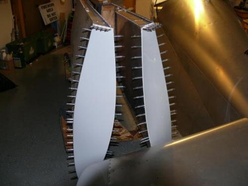

Measured, marked, and trimmed the left wing fiberglass wingtop. Trimmed with a cutoff wheel in the dremel tool. Spent some time trying to figure out how to mount the position light pods. Will probably get some help from friends wtih better 'glass skills.

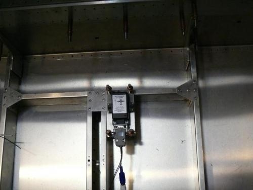

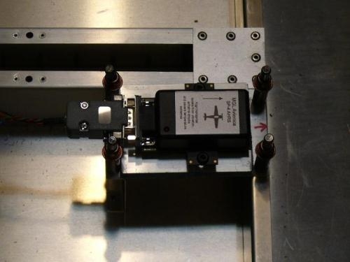

Lastly, I finished the attitude & horizon reference system (AHRS) which is a solid state gyro assembly for use with the Enigma EFIS. I had previously made the "pad" on which the AHRS will rest; tonight I fabricated a bracket, chose the mounting location close to centerline of the aircraft, and mounted it. I only riveted the support bracket thru the bottom of the fuselage so that I can remove the mount pad while I'm climbing in and out of the cockpit doing the wiring. I also secured the AHRS to the pad with velcro hook and loop fastener.
Both Tips Mounted (pilot drilled)
AHRS Mount
AHRS Mount
Positioned just to the right of centerline
