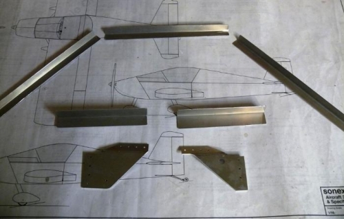

Brief Description: Cutting Glareshield Angle / Bend Panel Mounts
Measured, marked, and ripped 5 angle pieces. Three for the glareshield-to-firewall surfaces, and two for the fuel tank stops that mount underneath the glareshield.
Deburred. Still have to mark and pilot-drill.
Bent the left and right panel attach brackets to 30 degrees to match the panel inclination.
