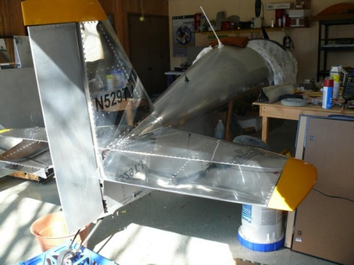

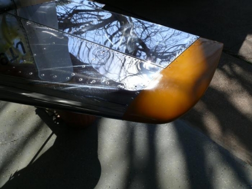

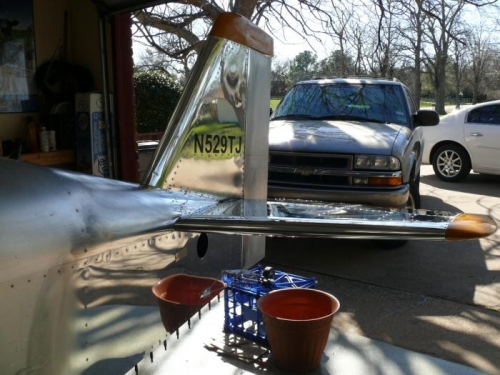

Compounded the right tail tip. Want to wait another day or two befoe buffing the left tip since the lower paint was touched up yesterday. Waxed the vertical and right horizontal tips. Removed newspaper masking material and cleaned up fuselage from 1-2 areas of light overspray, polishing compound over-fling, etc. Tail looks pretty good. Will look much better when I finally get around to obtaining some "S" grade finishing polish from NuVite.
