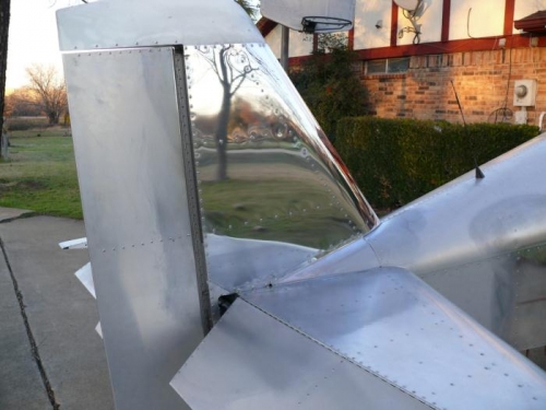

I then did 4 passes of polish (2 F, 2 C) on each side of the tail so that I could apply my N-numbers once the FAA says I'm legal.
I don't intend to polish the entire plane before first flight, but didn't want to polish over stuff I don't have to.

Tail Ready for N-numbers
