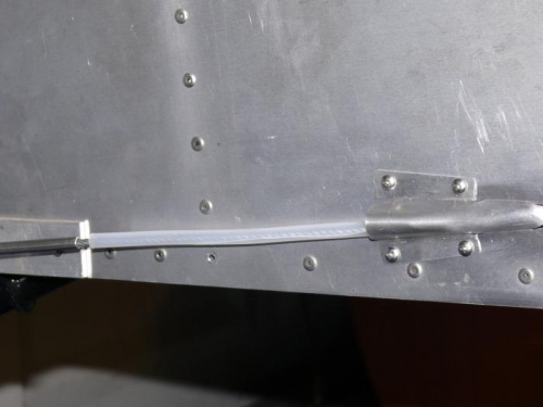

I found some polyethylene tubing at Lowes that was just a bit larger ID than the rudder cable diameter. I slit it down the side and installed it over the right side rudder cable. A one-foot length of it ensured that it would not get caught in the fuselage opening whether fully extended or retracted.

Sleeved Rudder Cable
