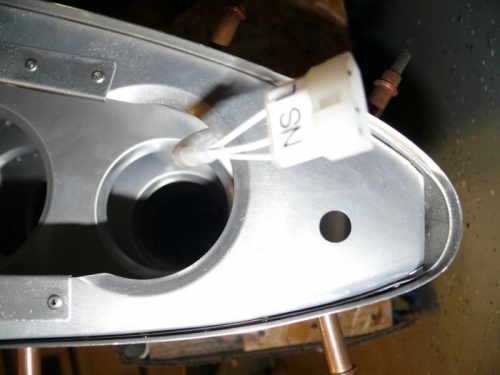

Next, I just had to finish the fuselage end of the left wing wiring after mounting the strobe units last Friday. I previously ran vinyl water tubing thru the forward rib forward holes. It was obvious, however, during wing rigging that this spot would be occluded by the fuselage side wall. The opening in the fuselage is only the size of the two rib lightening holes. On the right wing, I just made up a bracket for the wires and pitot/static. However, on the left side, the flap and brake levers partially occlude the opening. I was concerned that if I affixed a bracket to the fwd edge of the rib that I could not get my hand in there to attach the flap control rod. I decided to fasten the wire harness to the first bay of the wing, wrap the wires in protective sleeving, and let it hang free. There will not be a large amount of excess wire, so this should not be an issue.

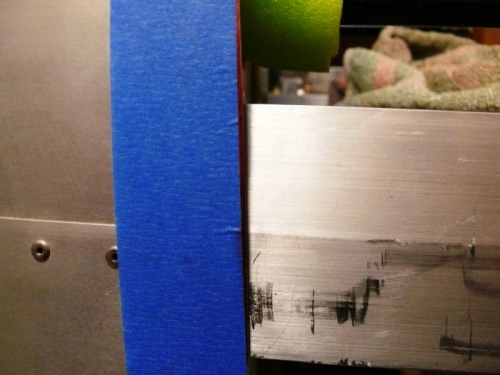

Lastly, I trimmed each wing's doubler in order to provide a 1/16" gap between the wing and fuselage. Protected the spar with scrap stock and used the vixen file to trim it, then followed-up with ScotchBrite to finish smoothing it out.
Wing, Right Side Up, showing wire orientatlion
Wing, Upside Down, showing routing of wire
Red Mark = area to trim on wing doubler
