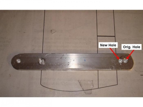

After rigging the rudder cables as per plans, I was not satisfied with the respective travel of the rudder pedals, right vs left. So, tonight I re-blocked the rudder in the centered position and determined that I needed to make a new rudder cable attach link. For grins, I drilled a test hole in the existing link where measurements said would create a better alignment. Quickly put back into position, and voila, the rudder pedal travel was perfect and the pedals matched perfectly when the rudder was centered.
Tomorrow I will make a new link, since the holes are a bit too close for comfort - don't want that web of material tearing just when I need it the most!
