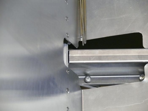

Remounted the seat. lightly screwd the hat section for the elevator rod in place. Noted that it was almost impossible to insert the lower seat hinge pins because of interference from the hat section. Removed and trimmed a bit. Could use a bit more trimming, but don't want an obvious open slot to accumulate stuff later that could jam the elevator control rod.

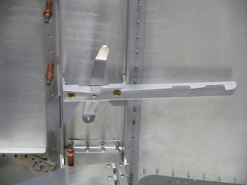

Bent trim control lever - 3 bends - one for operator use, and the other 2 to provide an offset for mounting the trim cable.

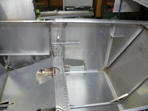

Fabricated and installed the trim and flap quadrant. Had to measure and locate the fore/aft attach brackets, pilot drill, updrill, deburr, and rivet into place. Lots of time on the detail measurements and trying to clamp stuff into position. Had to drill some holes to 3/16" for the cable housing, but left the final hole in the attach bracket at 3?32, which will allow only the control cable to pass thru.
Positioned and drilled the flap detent assy to the fore/aft brackets. Again, lots of measurements to get it level. Picture makes it look slanted, but in relation to the upper longeron, it's dead-on.
Close-up of trim/flap quadrant
Overall view
Showing interference of hat section to seat hinge pins
