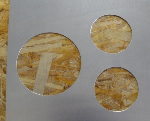

Continued / almost finished with seat pan fabrication. Did final finish on the center seat belt fastener / elevator control rod clearance slot in the middle of the seat. Pic 1.
Using large hole saws, cut the three holes on each side of the seat pan to form the corners of the control stick cutouts. Material between the holes is removed. Large hole in pic 2 is 4.5" in diameter; two other holes are 3".
Removed center material from between the holes; rough cut with a sabre saw, then followed up with a Vixen file and finer-tooth files for a nice finish. Wrapped it up with a ScotchBrite pad.
