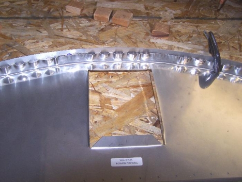

Brief Description:  Adjust Flutes on Upper Formed Firewall
Determined that although the factory-formed flutes on the flange of the upper firewall former were very pretty, I had to mess them up in order to fit the southco fasteners and fuel filler box flush with the upper flange.
Picture below shows the flattened locations of the upper 2 southcos and the filler box area where the flanges will fit.
