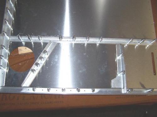

Continued with the location and pilot drilling of right fwd fuse detail parts. Added the gear mount angle and the seatbelt attach angle, and the upper/lower motor mounts.

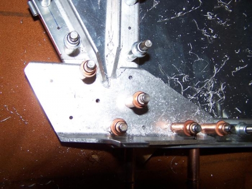

Mis-located the upper mount, but in checking SNX-P31, the motor mount page, I don't think it's going to be an issue. The upper mount is supposed to be 1.25" from the fwd edge of the fuse skin; mine is 1.1875 from the edge. The welded motor mount tubes do not have pilot holes in them, so all should be OK.
Gear Mount (left) and seat belt (right) angles
Right upper motor mount
