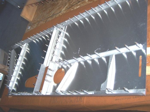

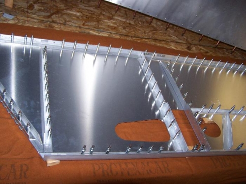

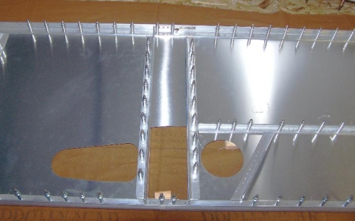

Brief Description: Parts Placement - Right Fwd Fuselage
Continued with initial parts location & pilot drilling.
Located and drilled the rudder pedal support angle, the fwd & aft wing attach angles, and the aft horizontal support. Just for grins, placed the seat belt attach and gear attach angles in place, but have not yet drilled / cleco'd them (these are the next two parts in the sequence called out in the plans).
