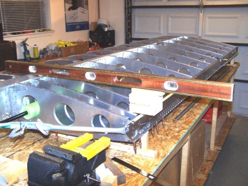

Positioned wing skeleton into position on the bench for ease of reach & working. Levelled to ensure accurate hole placement. Had to ship the outboard end about 1/8", otherwise pretty good.

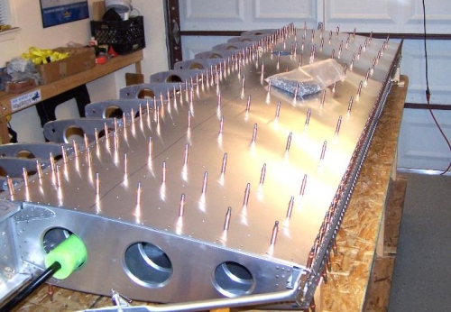

Cleco'd the skin into position. Riveted.
Levelling in Preparation
Cleco'd, Ready to Rivet
Riveted
