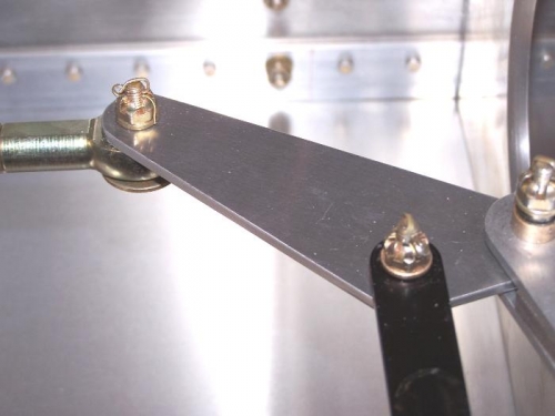

Aileron Control Rod Install / Deburr Aft Skin
Used compressed air and a vacuum cleaner to remove all FOD (chips) from left wing aft bay in preparation for closure.
Mounted control rods to aileron bellcrank, torqued, and installed cotter keys for safetying.
Deburred both upper and lower surfaces of the lower aft skin.
Next: re-level wing box, cleco skin into position, and rivet.
Left Wing Aileron Bellcrank / Rods
Skin Awaiting Deburr
