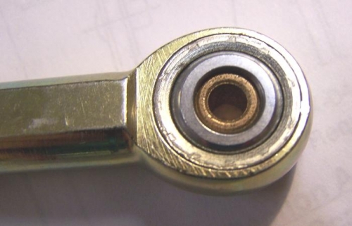

Parts threaded together nicely. Noticed that the plans said to use an MW-3 rod end, but the recommended HW list had MW-5's, and that's what Wicks sent with my HW kit. If you use the MW-5's, you need to insert a straight bushing to reduce the hole size down to 3/16" for an AN3 bolt. Image 2 shows the installed straight bushing.

Reducer bushing installed in rod end
