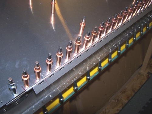

Brief Description: Position / Drill / Cleco Right Wing Flap Hinge
Marked centerline of hinge pair (5/8" from either edge), then positioned this onto the lower edge of the aft wing spar (wing is upside down in picture).
Drilled all hinge holes to #40, checking for binding and even spacing. Up-drilled to #30 in preparation for debur and riveting. (long ways to go before rivet, but getting close now).
