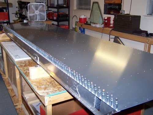

Brief Description: Right Wing Upper Aft Skin Fitment
Positioned and leveled right wing "skeleton". Set squareness of wing to 19" from station 0,0 to the center of the aft spar mounting hole. Braced in place with a home-made conduit jig.
Once level (no twist) and square, positioned upper aft wing skin, aligning pilot holes with the rib mount locations on the rear spar.
Drilled (#40) and cleco'd aft edge of upper aft skin to rear spar.
