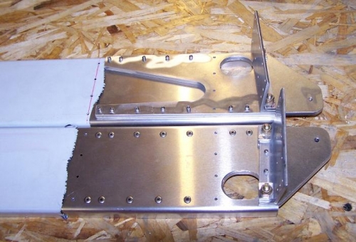

Completed Left Rear Spar
Quick wrap-up of the left rear spar.
Up-drilled all rivet holes to #30 (well, almost all. you're supposed to leave the holes that will eventually mount the aft ribs empty for now).
Removed all parts, deburred, then cleco'd into place.
Riveted with CCP-44's, except for the two CCP-46 rivets required for the root rib attach angle.

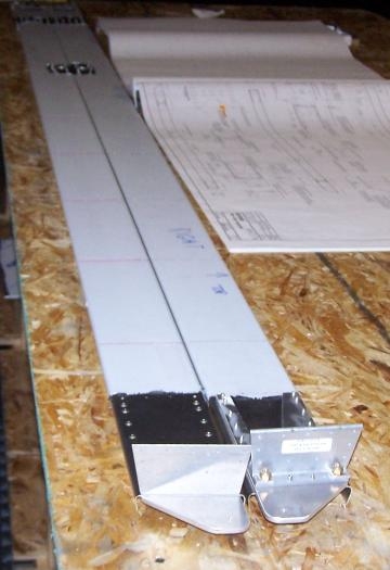

Completed rear spar pair
overall view of rear spars
