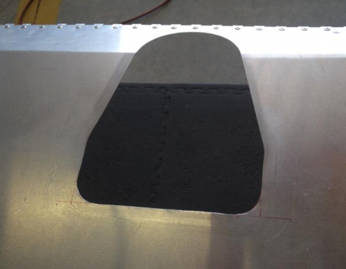

Enlarged the control stick holes in the seat pan; full aft control deflection was liimited, not to mention the scraping of the stick on the pan, rubbing away the powder coating. Hole was mostly a triangle shape. I just extended the lower portion by 7/8".
