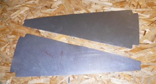

Brief Description:  Initial Fab Tail Fairings
Made paper pattern traced from plans page (as per direction) for tail fairings.
Transferred to sheet stock. Cut out two fairings. Filed profile to correct shape (straight lines aren't really straight), finished up with 1/4" round file and ScotchBrite wheel.
