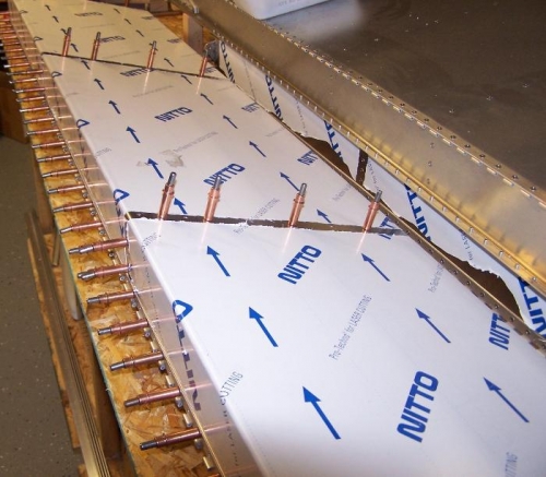

Right Flap Drill / Deburr / Prep for Rivet
Drilled skin-to-rib pilot holes, upper & lower skin surfaces. Up-drilled to #30.
Set up jig to space hinge .057" from flush with skin; drilled hinge. Up-drilled to #30.
Stripped protective plastic from rivet areas on skin. Disassembled all parts.
Deburred ribs. Deburred all skin surfaces inside and out.
Deburr hinge.
Cleco all together in preparation for riveting.
