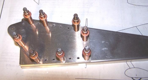

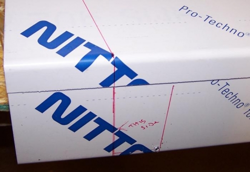

Started the right flap tonight.
Got out the parts, dug around for the flap drive plate, ribs, etc.
Marked out cut measurements on the right flap. Drilled 1/8" relief hole prior to cutting drive plate access hole.
Positioned, drilled, cleco'd and up-drilled SNX-W06-05R drive rib assembly.
Flap Marked Up
Drive Rib Cleco'd
