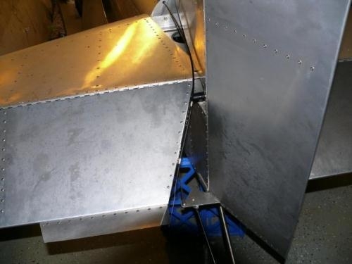

Install Trim Tab Actuator Cable / Drill Sticks

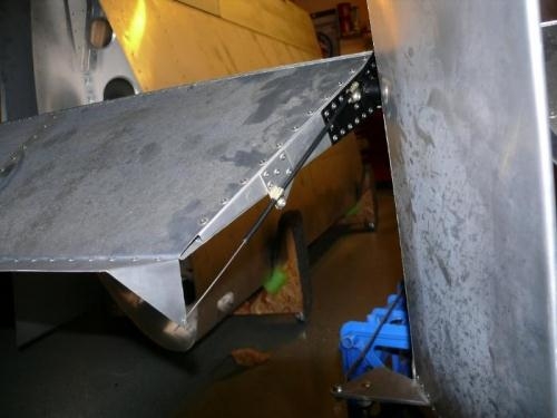

Installed the cable core; trimmed the cable housing to length at the trim adjust lever in the cockpit.
Bent the ""Z"" in the end of the cable as per plans; inserted into the trim tab, and secured with cable clamps (visible in 2nd picture below).
Drilled the control sticks at the bottom to allow PTT & memory swap button wiring to be installed. Insulated with rubber grommets.
