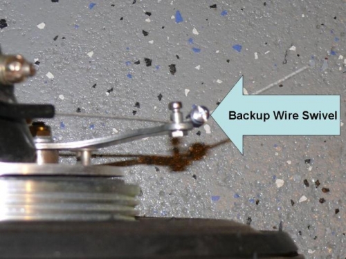

Finally got some wire swivels at the local mower shop. Had to up-drill the hole for the cable, as it was too small for the brake cable. My Tech Counselor advised that it would be a good idea to have a backup on the cables just in case one of the azuza swivels loosened up.
