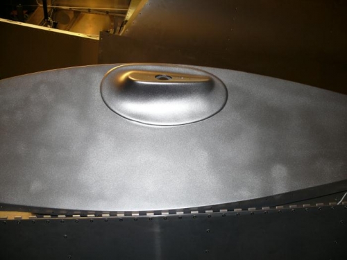

I found the paint I wanted for all the fiberglass, but I'm not thrilled with it. Lots of mottled areas. I'm hoping that once I sand it down and clear-coat it that a lot of the mottle will go away.

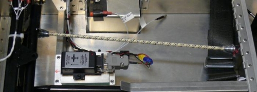

Next, I had previously installed one end on the elevator bungee cord (this keeps the elevator in neutral position at rest). Now that the controls are installed, I could connect it to the control stick assy. Pulled it to the point where it would support the elevator, marked, and cut to length. Installed the end piece, tied a knot in it, then crimped-on the retainer clip. Installed.

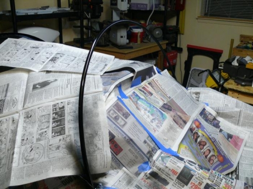

Lastly, I had previously painted the fwd windshield bow, but in all the fitting work with the windshield and canopy, it got banged up a bit. I masked everything off, then re-sprayed it.
Ugh. Painted wingtips
Elevator Bungee Cord
Painted WS Bow
Painted WS Bow
