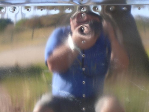

There are 3 grades of compounds recommended for use with the Sonex-supplied 6061-T6 alloy: F9, the coarsest cut, then C, a mid-grade product, followed by S, the final polish for that show-quality shine. I did not purchase "S" at the show, since I figured it would be some time before I'd be ready for it. After today, I'm not sure.

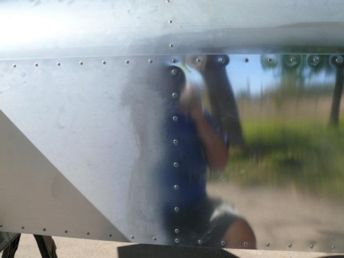

This went much better than I thought it would. I first applied one pass of F9. Wow. Impressed after the first pass! Followed that with another pass of F9. Even better! I decided to swap out buffer bonnets and try some "C" grade. Even better! Applied two coats of that.

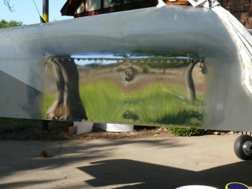

I then decided to do a second panel. the results of two passes of F9 followed by two passes of C are shown in pic 3 below. Better than I would have imagined! Not show quality yet, but much, much better than I would have imagined!

One pass using F9 against untreated 6061-T6
Left side 1 pass of
Left side 1 pass of "C", right side 2 passes of "F9"
Two passes
Two passes "F9" followed by 2 of "C"
