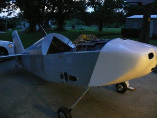

First off, I pushed the bird outside and gave it a sponge-bath. The past few months have not been kind to the bare aluminum, even in the garage. I removed a winter's worth of dust and dead insect appendages.

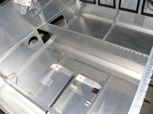

Next, I removed the flap control rod that I previously installed - don't make this mistake. The mounting blocks and the brake & flap levers will interfere with drilling the main spar bolt holes.
I then removed the aft spar tunnel and associated fixtures.

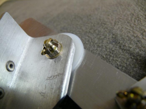

Lastly, when I originally installed the flap control tube and brake lever, I missed the point in the plans about putting a nylon washer between the bracket and the handle to smooth-out the pivoting action. Since the handle was now removed, I installed the missing washer (bought it a few months ago) and safetied-it with a new cotter pin.
aft spar tunnel & flap control rod removed
Cleaned up, with canopy on
newly-installed nylon washer for brake handle pivot
