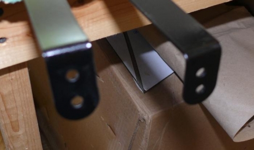

I then installed the tank straps to check the front ones. I had heard from other builders that they have had to shorten the front straps. From the kit, they are the same length as the rear straps, and since the fuselage narrows at the front, they are just too long.
I straightened the existing angle bend on the straps, drilled new holes for AN3 hardware, and re-bent the angles as shown in fig 2 below. I didn't see a need to cut off the old ends since no one will see them; I also didn't want to dull my bandsaw blade. Did another fit check and it appears they will be OK.

New bends / bolt holes in fwd straps
