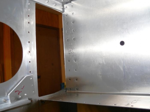

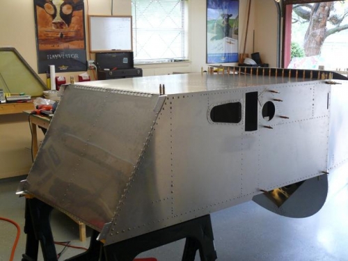

Finished initial riveting
Flush rivets for spar tunnel (fuse upside down)

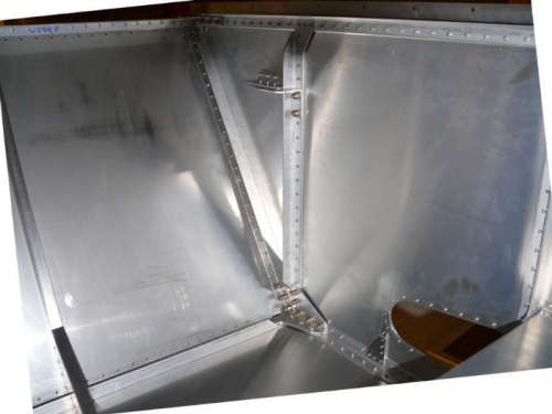

Looking forward from seat area
