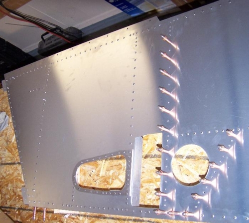

Brief Description:  Rivet Left Fwd Fuselage
Riveted all holes in left fwd fuselage that take rivets at this time. As shown in the picture, holes associated with the aft wing attach angle are not riveted at this time to allow construction of the tunnel zee.
Still need to install AN3 hardware on the motor mounts, seat belt attach angle, and the rudder pedal mount angle.
