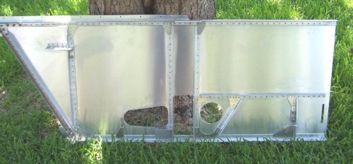

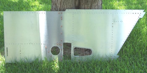

Brief Description: Riveted Right Side, Located Left Side

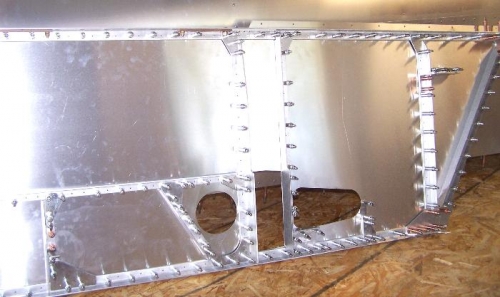

Riveted all required areas on the right forward fuselage. Some areas (those connected with the aft wing angle and the brackets connecting to that) are not riveted at this time in order to facilitate the spar tunnel and neighboring parts.
Following the riveting, installed AN3 fasteners for the upper and lower motor mounts, the rudder pedal attach angle, and the angle clip that fastens to the seat belt bracket.
Took a long break to run some errands; upon return, located all angle stock and pilot drilled for the left forward fuse. Tedious. All that remains on this is to flip over the panel to install the flap hole double plate and the upper/lower firewall attach angles. Then updrill, deburr, reassemble, and rivet.
