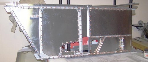

Brief Description:  Finished Locating Parts - Right Fwd Fuse
Located & pilot drilled (to 1/8 as per plans) the upper and lower firewall attach clips.
Located and pilot drilled doubler plate.
Up-drilled firewall attach clips to 3/16" as well as the other motor mount holes.
Up-drilled the doubler plate to #30.
All that remains: disassemble, deburr, and rivet. Well, most of the holes. Rivets in the area of the rear wing attach angle do not get riveted at this time.
